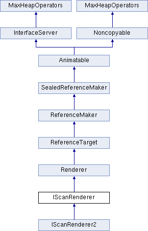

+ Inheritance diagram for IScanRenderer:
