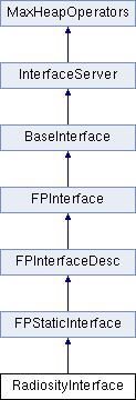

+ Inheritance diagram for RadiosityInterface:
