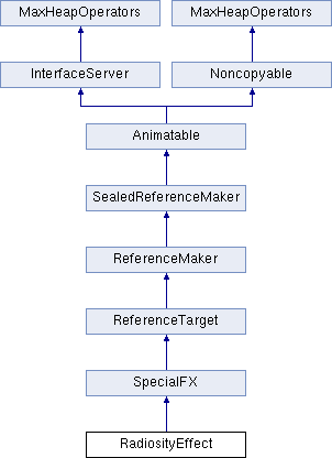

Inheritance diagram for RadiosityEffect:Public Types | |
