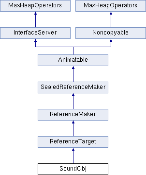

| virtual SClass_ID | SuperClassID () |
| | Retrieves a constant representing the type of the plugin. More...
| virtual BOOL | Play (TimeValue tStart, TimeValue t0, TimeValue t1, TimeValue frameStep)=0 |
| virtual void | Scrub (TimeValue t0, TimeValue t1)=0 |
| virtual TimeValue | Stop ()=0 |
| virtual TimeValue | GetTime ()=0 |
| virtual BOOL | Playing ()=0 |
| virtual void | SaveSound (PAVIFILE pfile, TimeValue t0, TimeValue t1)=0 |
| virtual void | SetMute (BOOL mute)=0 |
| virtual BOOL | IsMute ()=0 |
| virtual CoreExport void | GetClassName (MSTR &s) |
| | Retrieves the name of the plugin class. More...
| virtual BOOL | IsRefTarget () |
| | Checks if this is a ReferenceTarget. More...
| CoreExport RefResult | TestForLoop (const Interval &refInterval, RefMakerHandle hmaker) |
| | Tests for a cyclical reference. More...
| CoreExport BOOL | HasDependents () |
| | Checks if a ReferenceTarget has references. More...
| CoreExport BOOL | HasRealDependents () |
| | Checks if this has Real (Strong) Dependents. More...
| void | BeginDependencyTest () |
| | Starts Dependency Test. More...
| BOOL | EndDependencyTest () |
| | Ends Dependency Test. More...
| virtual void | RefAdded (RefMakerHandle rm) |
| | Called after a reference is made to a target. More...
| virtual void | RefAddedUndoRedo (RefMakerHandle rm) |
| | Called after a reference is made to a target because of undo or redo. More...
| virtual void | RefDeleted () |
| | Called after a references to this is deleted. More...
| virtual void | RefDeletedUndoRedo () |
| | Called after a references to this is deleted because of undo or redo. More...
| CoreExport RefResult | DeleteAllRefsToMe () |
| | Deletes all references to this ReferenceTarget. More...
| CoreExport RefResult | TransferReferences (RefTargetHandle oldTarget, BOOL delOld=FALSE) |
| | Transfers all the references from oldTarget to this. More...
| CoreExport int | DoEnumDependents (DependentEnumProc *dep) |
| | Begins an enumeration that searches back in the dependency network. More...
| virtual CoreExport RefTargetHandle | Clone (RemapDir &remap) |
| | This method is used by 3ds Max to clone an object. More...
| virtual CoreExport void | BaseClone (ReferenceTarget *from, ReferenceTarget *to, RemapDir &remap) |
| | This method copies base class data from an object to its clone. More...
| virtual CoreExport RefResult | NotifyDependents (const Interval &changeInt, PartID partID, RefMessage message, SClass_ID sclass=NOTIFY_ALL, BOOL propagate=TRUE, RefTargetHandle hTarg=NULL) |
| | Notify all dependent RefMakers concerned with the message. More...
| void | FlagDependents (TimeValue t, PartID which=PART_PUT_IN_FG) |
| | This sends the REFMSG_FLAGDEPENDENTS message up the pipeline. More...
| virtual void | NotifyForeground (TimeValue t) |
| | This method is called to flag dependents into the FG. More...
| virtual void | NotifyTarget (int message, ReferenceMaker *hMaker) |
| | Sends messages to ReferenceTargets. More...
| virtual CoreExport void * | GetInterface (ULONG id) |
| | Inherited from Animatable. More...
| virtual CoreExport BaseInterface * | GetInterface (Interface_ID id) |
| CoreExport | ReferenceTarget () |
| | Constructor. More...
| virtual CoreExport RefResult | AutoDelete () |
| | Deletes the object when it has no more real dependents. More...
| CoreExport RefResult | MaybeAutoDelete () |
| CoreExport RefResult | ReplaceReference (int which, RefTargetHandle newtarg, BOOL delOld=TRUE) |
| | Used when cloning reference makers. More...
| CoreExport RefResult | DeleteAllRefsFromMe () |
| | Deletes all references from this ReferenceMaker. More...
| CoreExport RefResult | DeleteAllRefs () |
| | Deletes all references both to and from this item. More...
| CoreExport RefResult | DeleteReference (int i) |
| | Deletes the specified reference. More...
| virtual BOOL | CanTransferReference (int i) |
| | Tells whether this reference can be transfered. More...
| CoreExport ReferenceSaveManager & | GetReferenceSaveManager () |
| | Access the ReferenceSaveManager of this ReferenceMaker. More...
| virtual CoreExport IOResult | Save (ISave *isave) |
| | Called for saving data. More...
| virtual CoreExport IOResult | Load (ILoad *iload) |
| | Called for loading data. More...
| virtual int | RemapRefOnLoad (int iref) |
| | Used to load old files with references. More...
| virtual CoreExport void | RescaleWorldUnits (float f) |
| | Rescale size of all world units in reference hierarchy. More...
| virtual CoreExport void | EnumAuxFiles (AssetEnumCallback &assetEnum, DWORD flags) |
| | Enumerate auxiliary files (e.g. bitmaps) More...
| virtual CoreExport void | SaveEnum (SaveEnumProc &sep, BOOL isNodeCall=0) |
| | The default save enumeration. More...
| virtual CoreExport bool | SpecifySaveReferences (ReferenceSaveManager &referenceSaveManager) |
| | Used to specify reference slot remapping during scene file save. More...
| CoreExport bool | EnumRefHierarchy (RefEnumProc &proc, bool includeCustAttribs=true, bool includeIndirectRefs=true, bool includeNonPersistentRefs=true, bool preventDuplicatesViaFlag=true) |
| | This method provides a general purpose reference enumerator. More...
| CoreExport int | FindRef (RefTargetHandle rtarg) |
| | Get the index of the ReferenceTarget. More...
| virtual BOOL | IsRefMaker () |
| | Tells whether it is a ReferenceMaker. More...
| virtual BOOL | IsRealDependency (ReferenceTarget *rtarg) |
| | Returns whether this is a "real" (strong) dependency or not. More...
| virtual BOOL | ShouldPersistWeakRef (RefTargetHandle rtarg) |
| | Specifies whether a weak reference is to be persisted on a partial load or save. More...
| CoreExport | ReferenceMaker () |
| CoreExport void | DeleteMe () |
| | Deletes an instance of this class. More...
| virtual CoreExport int | NumRefs () |
| | Returns the total number of references this ReferenceMaker can hold. More...
| virtual CoreExport RefTargetHandle | GetReference (int i) |
| | Returns the 'i-th' reference. More...
| void | SetAFlag (DWORD mask) |
| | Sets one or more bits in the Animatable flags. More...
| void | ClearAFlag (DWORD mask) |
| | Clears one or more bits in the Animatable flags. More...
| BOOL | TestAFlag (DWORD mask) |
| | Tests one or more bits in the Animatable flags. More...
| void | SetAFlagEx (DWORD mask) |
| | Sets one or more bits in the Animatable extended flags. More...
| void | ClearAFlagEx (DWORD mask) |
| | Clears one or more bits in the Animatable extended flags. More...
| BOOL | TestAFlagEx (DWORD mask) |
| | Tests one or more bits in the Animatable extended flags. More...
| CoreExport bool | TestFlagBit (int index) |
| | Tests the specified flag bit. More...
| CoreExport void | SetFlagBit (int index, bool newValue=true) |
| | Sets the specified flag bit. More...
| CoreExport void | ClearFlagBit (int index) |
| | Clears the specified flag bit. More...
| virtual void | FreeCaches () |
| virtual void | BeginEditParams (IObjParam *ip, ULONG flags, Animatable *prev=NULL) |
| virtual void | EndEditParams (IObjParam *ip, ULONG flags, Animatable *next=NULL) |
| virtual CoreExport void | ReleaseInterface (ULONG id, void *i) |
| virtual CoreExport int | SetProperty (ULONG id, void *data) |
| virtual CoreExport void * | GetProperty (ULONG id) |
| CoreExport void | AppendProperty (AnimProperty *prop) |
| | A function to directly add arbitrary properties to this object developers should ensure that the properties ID does not conflict with any Max-specific IDs. More...
| CoreExport AnimProperty * | FindProperty (DWORD id) |
| | Find any property. More...
| virtual int | NumSubs () |
| virtual Animatable * | SubAnim (int i) |
| virtual CoreExport MSTR | SubAnimName (int i) |
| virtual BOOL | BypassTreeView () |
| virtual BOOL | BypassTrackBar () |
| virtual BOOL | BypassPropertyLevel () |
| virtual BOOL | InvisibleProperty () |
| virtual BOOL | AssignController (Animatable *control, int subAnim) |
| virtual BOOL | CanAssignController (int subAnim) |
| | Return true if we can reassign the subanim specified. More...
| virtual BOOL | CanDeleteSubAnim (int i) |
| virtual void | DeleteSubAnim (int i) |
| virtual DWORD | GetSubAnimCurveColor (int subNum) |
| virtual int | SubNumToRefNum (int subNum) |
| virtual BOOL | CanCopyAnim () |
| virtual BOOL | CanMakeUnique () |
| virtual int | NumChildren () |
| virtual Animatable * | ChildAnim (int i) |
| virtual CoreExport MSTR | NodeName () |
| CoreExport int | EnumAnimTree (AnimEnum *animEnum, Animatable *client, int subNum) |
| CoreExport int | HasSubElements (int type=0) |
| virtual int | RenderBegin (TimeValue t, ULONG flags=0) |
| virtual int | RenderEnd (TimeValue t) |
| virtual void | EditTrack () |
| virtual int | NumKeys () |
| virtual TimeValue | GetKeyTime (int index) |
| virtual int | GetKeyIndex (TimeValue t) |
| virtual BOOL | GetNextKeyTime (TimeValue t, DWORD flags, TimeValue &nt) |
| virtual void | CopyKeysFromTime (TimeValue src, TimeValue dst, DWORD flags) |
| virtual void | DeleteKeyAtTime (TimeValue t) |
| virtual BOOL | IsKeyAtTime (TimeValue t, DWORD flags) |
| virtual int | GetKeyTimes (Tab< TimeValue > ×, Interval range, DWORD flags) |
| virtual int | GetKeySelState (BitArray &sel, Interval range, DWORD flags) |
| CoreExport void | OpenTreeEntry (int type, DWORD tv) |
| CoreExport void | CloseTreeEntry (int type, DWORD tv) |
| CoreExport int | IsTreeEntryOpen (int type, DWORD tv) |
| CoreExport BOOL | GetSelInTrackView (DWORD tv) |
| CoreExport void | SetSelInTrackView (DWORD tv, BOOL sel) |
| CoreExport BOOL | InTrackViewSelSet (int which) |
| CoreExport void | SetTrackViewSelSet (int which, BOOL inOut) |
| virtual CoreExport Interval | GetTimeRange (DWORD flags) |
| virtual void | EditTimeRange (Interval range, DWORD flags) |
| virtual void | DeleteTime (Interval iv, DWORD flags) |
| virtual void | ReverseTime (Interval iv, DWORD flags) |
| virtual void | ScaleTime (Interval iv, float s) |
| virtual void | InsertTime (TimeValue ins, TimeValue amount) |
| virtual BOOL | SupportTimeOperations () |
| virtual CoreExport void | MapKeys (TimeMap *map, DWORD flags) |
| virtual void | DeleteKeys (DWORD flags) |
| virtual void | DeleteKeyByIndex (int index) |
| virtual void | SelectKeys (TrackHitTab &sel, DWORD flags) |
| virtual void | SelectSubKeys (int subNum, TrackHitTab &sel, DWORD flags) |
| virtual void | SelectSubCurve (int subNum, BOOL sel) |
| virtual void | SelectKeyByIndex (int i, BOOL sel) |
