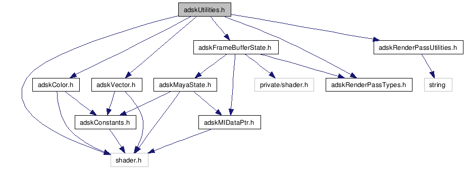

Include dependency graph for adskUtilities.h:

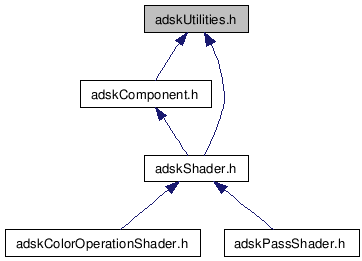

This graph shows which files directly or indirectly include this file:
