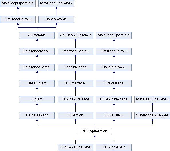

PFSimpleAction Class Reference
PFSimpleAction Class Referenceabstract
#include <PFSimpleAction.h>
+ Inheritance diagram for PFSimpleAction:
