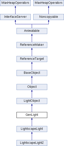

This class describes a generic light object. It is used as a base class for creating plug-in lights. Methods of this class are used to get and set properties of the light. All methods of this class are virtual.
+ Inheritance diagram for GenLight:
