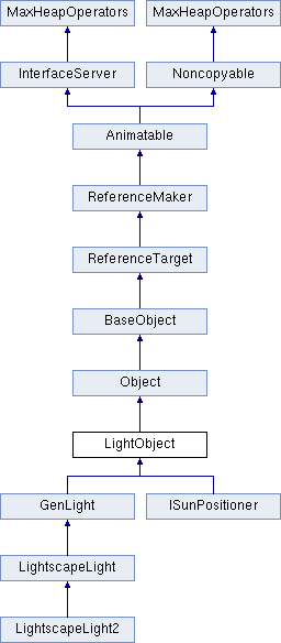

#include <object.h>
This is the base class from which plug-in lights may be derived.
Inheritance diagram for LightObject:Public Member Functions | |

| virtual void | PointsWereChanged () |
| Informs the object that its points have been deformed, so it can invalidate its cache. More... | |
| virtual CoreExport void | Deform (Deformer *defProc, int useSel=0) |
| This is the method used to deform the object with a deformer. More... | |
| virtual CoreExport void | GetDeformBBox (TimeValue t, Box3 &box, Matrix3 *tm=NULL, BOOL useSel=FALSE) |
| This method computes the bounding box in the objects local coordinates or the optional space defined by tm. More... | |
| virtual int | IsMappable () |
| This method lets you know if the ApplyUVWMap() method is available for this object. More... | |
| virtual int | NumMapChannels () |
| Returns the maximum number of channels supported by this type of object. More... | |
| virtual int | NumMapsUsed () |
| Returns the number of maps currently used by this object. More... | |
| virtual void | ApplyUVWMap (int type, float utile, float vtile, float wtile, int uflip, int vflip, int wflip, int cap, const Matrix3 &tm, int channel=1) |
| This method may be called to map the object with UVW mapping coordinates. More... | |
| virtual CoreExport int | CanConvertToType (Class_ID obtype) |
| Indicates whether the object can be converted to the specified type. More... | |
| virtual CoreExport Object * | ConvertToType (TimeValue t, Class_ID obtype) |
| This method converts this object to the type specified and returns a pointer it. More... | |
| virtual Class_ID | PreferredCollapseType () |
| This method allows objects to specify the class that is the best class to convert to when the user collapses the stack. More... | |
| virtual CoreExport void | GetCollapseTypes (Tab< Class_ID > &clist, Tab< MSTR * > &nlist) |
| When the user clicks on the Edit Stack button in the modify branch a list of 'Convert To:' types is presented. More... | |
| virtual Object * | CollapseObject () |
| This method is called on the world space cache object when the stack gets collapsed, that lets the pipeline object decide, if it wants to return a different object than itself. More... | |
| virtual DWORD | GetSubselState () |
| For objects that have sub selection levels, this method returns the current selection level of the object. More... | |
| virtual void | SetSubSelState (DWORD s) |
| CoreExport void | ReadyChannelsForMod (ChannelMask channels) |
| Implemented by the System. More... | |
| virtual CoreExport Interval | ChannelValidity (TimeValue t, int nchan) |
| Retrieve the current validity interval for the nchan channel of the object. More... | |
| virtual CoreExport void | SetChannelValidity (int nchan, Interval v) |
| Sets the validity interval of the specified channel. More... | |
| virtual CoreExport void | InvalidateChannels (ChannelMask channels) |
| This method invalidates the intervals for the given channel mask. More... | |
| virtual CoreExport Interval | ObjectValidity (TimeValue t) |
| This method returns the validity interval of the object as a whole at the specified time. More... | |
| virtual Object * | MakeShallowCopy (ChannelMask channels) |
| This method must make a copy of its "shell" and then shallow copy (see below) only the specified channels. More... | |
| virtual CoreExport void | ShallowCopy (Object *fromOb, ChannelMask channels) |
| This method copies the specified channels from the fromOb to this and copies the validity intervals. More... | |
| virtual CoreExport void | FreeChannels (ChannelMask channels) |
| This method deletes the memory associated with the specified channels and set the intervals associated with the channels to invalid (empty). More... | |
| virtual CoreExport void | NewAndCopyChannels (ChannelMask channels) |
| This method replaces the locked channels with newly allocated copies. More... | |
| virtual CoreExport void | MaybeEnlargeViewportRect (GraphicsWindow *gw, Rect &rect) |
| This method allows the object to enlarge its viewport rectangle, if it wants to. More... | |
| CoreExport bool | IsBaseClassOwnedChannel (int nchan) |
| CoreExport void | UpdateValidity (int nchan, Interval v) |
| When a modifier is applied to an object, it needs to include its own validity interval in the interval of the object. More... | |
| Interval | GetNoEvalInterval () |
| void | SetNoEvalInterval (Interval iv) |
| virtual CoreExport void | ReduceCaches (TimeValue t) |
| This method give the object the chance to reduce its caches. More... | |
| virtual int | IsConstObject () |
| This is called to determine if this is a construction object or not. More... | |
| virtual int | NumPipeBranches (bool selected=true) |
| This method returns the number of pipeline branches combined by the object. More... | |
| virtual Object * | GetPipeBranch (int i, bool selected=true) |
| Retrieves sub-object branches from an object that supports branching. More... | |
| virtual INode * | GetBranchINode (TimeValue t, INode *node, int i, bool selected=true) |
| When an object has sub-object branches, it is likely that the sub-objects are transformed relative to the object. More... | |
| virtual int | NumberOfContainedShapes () |
| Returns the number of shapes contained inside this object. More... | |
| virtual ShapeObject * | GetContainedShape (TimeValue t, int index) |
| This method returns the ShapeObject specified by the index passed at the time specified. More... | |
| virtual void | GetContainedShapeMatrix (TimeValue t, int index, Matrix3 &mat) |
| Returns the matrix associated with the shape whose index is passed. More... | |
| virtual BitArray | ContainedShapeSelectionArray () |
| This is used by the lofter. More... | |
| virtual BOOL | IsShapeObject () |
| virtual BOOL | CheckObjectIntegrity () |
| This method is used for debugging only. More... | |
| virtual BOOL | HasUVW () |
| Call this method to find out if the object has UVW coordinates. More... | |
| virtual BOOL | HasUVW (int mapChannel) |
| Call this method to find out if the object is has UVW coordinates for the specified mapping channel. More... | |
| virtual Object * | FindBaseObject () |
| It is called to return a pointer to the base object (an object that is not a derived object). More... | |
| virtual BOOL | IsParamSurface () |
| There are several methods used to access a parametric position on the surface of the object. More... | |
| virtual int | NumSurfaces (TimeValue t) |
| Returns the number of parametric surfaces within the object. More... | |
| virtual Point3 | GetSurfacePoint (TimeValue t, float u, float v, Interval &iv) |
| This method needs to be implemented if Object::IsParamSurface() returns TRUE. More... | |
| virtual Point3 | GetSurfacePoint (TimeValue t, int surface, float u, float v, Interval &iv) |
| This method is used to retrieve a point on the specified surface of the object based on two parameters of the surface, u and v. More... | |
| virtual void | SurfaceClosed (TimeValue t, int surface, BOOL &uClosed, BOOL &vClosed) |
| This method allows the object to return flags that indicate whether the parametric surface is closed in the U and V dimensions. More... | |
| virtual BOOL | GetExtendedProperties (TimeValue t, MSTR &prop1Label, MSTR &prop1Data, MSTR &prop2Label, MSTR &prop2Data) |
| This method allows an object to return extended Properties fields. More... | |
| CoreExport SvGraphNodeReference | SvTraverseAnimGraph (IGraphObjectManager *gom, Animatable *owner, int id, DWORD flags) |
| CoreExport bool | SvHandleDoubleClick (IGraphObjectManager *gom, IGraphNode *gNode) |
| CoreExport MSTR | SvGetName (IGraphObjectManager *gom, IGraphNode *gNode, bool isBeingEdited) |
| CoreExport COLORREF | SvHighlightColor (IGraphObjectManager *gom, IGraphNode *gNode) |
| CoreExport bool | SvIsSelected (IGraphObjectManager *gom, IGraphNode *gNode) |
| Returns true if the object is selected in its schematic view. More... | |
| CoreExport MultiSelectCallback * | SvGetMultiSelectCallback (IGraphObjectManager *gom, IGraphNode *gNode) |
| CoreExport bool | SvCanSelect (IGraphObjectManager *gom, IGraphNode *gNode) |
| CoreExport void | AddXTCObject (XTCObject *pObj, int priority=0, int branchID=-1) |
| This method adds an extension object into the pipeline. More... | |
| CoreExport int | NumXTCObjects () |
| Returns the number of extension objects maintained by this Object. More... | |
| CoreExport XTCObject * | GetXTCObject (int index) |
| Returns a pointer to the specified extension object. More... | |
| CoreExport void | RemoveXTCObject (int index) |
| Removes the extension object as indicated by the index. More... | |
| CoreExport void | SetXTCObjectPriority (int index, int priority) |
| Sets the priority for the extension object whose index is passed. More... | |
| CoreExport int | GetXTCObjectPriority (int index) |
| Returns the integer priority number of the extension object whose index is passed. More... | |
| CoreExport void | SetXTCObjectBranchID (int index, int branchID) |
| Sets the branch ID of the extension object whose index is passed. More... | |
| CoreExport int | GetXTCObjectBranchID (int index) |
| Returns the integer branch ID of the extension object whose index is passed. More... | |
| CoreExport void | MergeAdditionalChannels (Object *from, int branchID) |
| This method has to be called whenever the CompoundObject updates a branch (calling Eval() on it). More... | |
| CoreExport void | BranchDeleted (int branchID, bool reorderChannels) |
| This method has to be called on the CompoundObject so it can delete the XTCObjects for the specified branch. More... | |
| CoreExport void | CopyAdditionalChannels (Object *from, bool deleteOld=true, bool bShallowCopy=false) |
| This method copies all extension objects from the "from" object into the current object. More... | |
| CoreExport void | DeleteAllAdditionalChannels () |
| virtual BOOL | UseSelectionBrackets () |
| This method allows an object to choose whether or not it will display selection brackets in shaded viewports. More... | |
| virtual BOOL | IsManipulator () |
| virtual void | ReduceDisplayCaches () |
| Should reduce any derived display data to save memory, since the node wont be drawn until the user undhides it. More... | |
| virtual bool | NeedGWCacheRebuilt (GraphicsWindow *gw, Material *ma, int numMat) |
| This returns whether the Graphics Cache for this object needs to be rebuilt. More... | |
| virtual void | BuildGWCache (GraphicsWindow *gw, Material *ma, int numMat, BOOL threaded) |
| This builds the graphics window cached mesh. More... | |

Reimplemented in GenLight.
Sets the type of shadows used by the light - mapped or raytraced.
| a | One of the following values: 0: This value plugs in a Shadow Map Generator 1: This value plugs in a Raytraced Shadow Generator. Any other value is a NOOP. |
inlinevirtual |
Returns the lights Absolute Map Bias setting.
Sets the lights Absolute Map Bias setting.
| a | Nonzero indicates Absolute Map Bias is on; zero indicates it is off. |
inlinevirtual |
Returns the lights Overshoot on / off setting.
Nonzero indicates overshoot is on; otherwise 0.
Sets the lights Overshoot on / off setting.
| a | Nonzero indicates overshoot is on; otherwise 0. |
inlinevirtual |
inlinevirtual |
inlinevirtual |
inlinevirtual |
Sets the image(s) used by the projector light.
| pmap | The map to use. |
Updates the display of the light's target distance in the light's rollup page.
| t | The time to retrieve the distance. |
| inode | The light node. |
Reimplemented in LightscapeLight.
