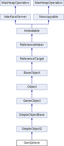

| virtual void | SetParams (float rad, int segs, BOOL smooth=TRUE, BOOL genUV=TRUE, float hemi=0.0f, BOOL squash=FALSE, BOOL recenter=FALSE)=0 |
| | SimpleObject2 () |
| int | NumSubs () override |
| Animatable * | SubAnim (int i) override |
| CoreExport MSTR | SubAnimName (int i) override |
| int | NumParamBlocks () override |
| IParamBlock2 * | GetParamBlock (int i) override |
| IParamBlock2 * | GetParamBlockByID (BlockID id) override |
| int | NumRefs () override |
| | Returns the total number of references this ReferenceMaker can hold. More...
| RefTargetHandle | GetReference (int i) override |
| | Returns the 'i-th' reference. More...
| CoreExport | SimpleObjectBase () |
| CoreExport | ~SimpleObjectBase () |
| CoreExport void | UpdateMesh (TimeValue t) |
| CoreExport void | GetBBox (TimeValue t, Matrix3 &tm, Box3 &box) |
| void | MeshInvalid () |
| CoreExport void | BeginEditParams (IObjParam *ip, ULONG flags, Animatable *prev) |
| CoreExport void | EndEditParams (IObjParam *ip, ULONG flags, Animatable *next) |
| CoreExport int | HitTest (TimeValue t, INode *inode, int type, int crossing, int flags, IPoint2 *p, ViewExp *vpt) |
| | This method is called to determine if the specified screen point intersects the item. More...
| CoreExport void | Snap (TimeValue t, INode *inode, SnapInfo *snap, IPoint2 *p, ViewExp *vpt) |
| | Checks the point passed for a snap and updates the SnapInfo structure. More...
| CoreExport int | Display (TimeValue t, INode *inode, ViewExp *vpt, int flags) |
| | This is called by the system to have the item display itself (perform a quick render in viewport, using the current TM). More...
| CoreExport unsigned long | GetObjectDisplayRequirement () const |
| CoreExport bool | PrepareDisplay (const MaxSDK::Graphics::UpdateDisplayContext &prepareDisplayContext) |
| CoreExport bool | UpdatePerNodeItems (const MaxSDK::Graphics::UpdateDisplayContext &updateDisplayContext, MaxSDK::Graphics::UpdateNodeContext &nodeContext, MaxSDK::Graphics::IRenderItemContainer &targetRenderItemContainer) |
| CoreExport ObjectState | Eval (TimeValue time) |
| | This method is called to evaluate the object and return the result as an ObjectState. More...
| void | InitNodeName (MSTR &s) |
| | This is the default name of the node when it is created. More...
| CoreExport Interval | ObjectValidity (TimeValue t) |
| | This method returns the validity interval of the object as a whole at the specified time. More...
| CoreExport int | CanConvertToType (Class_ID obtype) |
| | Indicates whether the object can be converted to the specified type. More...
| CoreExport Object * | ConvertToType (TimeValue t, Class_ID obtype) |
| | This method converts this object to the type specified and returns a pointer it. More...
| CoreExport BOOL | PolygonCount (TimeValue t, int &numFaces, int &numVerts) |
| | Retreives the number of faces and vertices of the polyginal mesh representation of this object. More...
| CoreExport int | IntersectRay (TimeValue t, Ray &ray, float &at, Point3 &norm) |
| | This method is called to compute the intersection point and surface normal at this intersection point of the ray passed and the object. More...
| CoreExport void | GetWorldBoundBox (TimeValue t, INode *inode, ViewExp *vpt, Box3 &box) |
| | This method returns the world space bounding box for Objects (see below for the Sub-object gizmo or Modifiers gizmo version). More...
| CoreExport void | GetLocalBoundBox (TimeValue t, INode *inode, ViewExp *vpt, Box3 &box) |
| | This is the object space bounding box, the box in the object's local coordinates. More...
| CoreExport void | GetDeformBBox (TimeValue t, Box3 &box, Matrix3 *tm, BOOL useSel) |
| | This method computes the bounding box in the objects local coordinates or the optional space defined by tm. More...
| CoreExport Mesh * | GetRenderMesh (TimeValue t, INode *inode, View &view, BOOL &needDelete) |
| | This method should be implemented by all renderable GeomObjects. More...
| CoreExport void | FreeCaches () |
| void | GetClassName (MSTR &s) |
| | Retrieves the (localizable) name of the plugin class. More...
| virtual CoreExport BaseInterface * | GetInterface (Interface_ID iid) |
| | Inherited from Animatable. More...
| CoreExport void * | GetInterface (ULONG id) |
| CoreExport RefResult | NotifyRefChanged (const Interval &changeInt, RefTargetHandle hTarget, PartID &partID, RefMessage message, BOOL propagate) |
| | Receives and responds to messages. More...
| virtual void | BuildMesh (TimeValue t)=0 |
| virtual BOOL | OKtoDisplay (TimeValue t) |
| virtual void | InvalidateUI () |
| SClass_ID | SuperClassID () |
| | Retrieves a constant representing the type of the plugin. More...
| virtual int | IsRenderable () |
| | Indicates whether the object may be rendered. More...
| virtual int | IsInstanceDependent () |
| | If an object creates different meshes depending on the particular instance (view-dependent) it should return nonzero; otherwise 0. More...
| virtual int | NumberOfRenderMeshes () |
| | Objects may supply multiple render meshes ( e.g. More...
| virtual Mesh * | GetMultipleRenderMesh (TimeValue t, INode *inode, View &view, BOOL &needDelete, int meshNumber) |
| | For multiple render meshes, this method must be implemented. More...
| virtual void | GetMultipleRenderMeshTM (TimeValue t, INode *inode, View &view, int meshNumber, Matrix3 &meshTM, Interval &meshTMValid) |
| virtual CoreExport PatchMesh * | GetRenderPatchMesh (TimeValue t, INode *inode, View &view, BOOL &needDelete) |
| | This method provides a patch mesh representation of the object for use by the renderer. More...
| CoreExport Class_ID | PreferredCollapseType () |
| | This method allows objects to specify the class that is the best class to convert to when the user collapses the stack. More...
| virtual BOOL | CanDoDisplacementMapping () |
| | Returns TRUE if this object can do displacement mapping; otherwise FALSE. More...
| CoreExport | Object () |
| CoreExport | ~Object () |
| virtual int | UsesWireColor () |
| | This method determines if the object color is used for display. More...
| virtual int | DoOwnSelectHilite () |
| | If an object wants to draw itself in the 3D viewports in its selected state in some custom manner this method should return nonzero. More...
| virtual BOOL | NormalAlignVector (TimeValue t, Point3 &pt, Point3 &norm) |
| | Objects that don't support the IntersectRay() method (such as helper objects) can implement this method to provide a default vector for use with the normal align command in 3ds Max. More...
| void | LockObject () |
| | Implemented by the System. More...
| void | UnlockObject () |
| int | IsObjectLocked () |
| void | LockChannels (ChannelMask channels) |
| void | UnlockChannels (ChannelMask channels) |
| ChannelMask | GetChannelLocks () |
| void | SetChannelLocks (ChannelMask channels) |
| ChannelMask | GetChannelLocks (ChannelMask m) |
| virtual BOOL | CanCacheObject () |
| | This method determines if this object can have channels cached. More...
| virtual void | WSStateInvalidate () |
| | This is called by a node when the node's world space state has become invalid. More...
| virtual BOOL | IsWorldSpaceObject () |
| | Returns TRUE if the object as a world space object; otherwise FALSE. More...
| CoreExport INode * | GetWorldSpaceObjectNode () |
| virtual BOOL | IsParticleSystem () |
| CoreExport void | CopyChannelLocks (Object *obj, ChannelMask needChannels) |
| virtual void | TopologyChanged () |
| virtual int | IsDeformable () |
| | Indicates whether this object is deformable. More...
| virtual int | NumPoints () |
| | The points of a deformable object are accessed through a virtual array interface. More...
| virtual Point3 | GetPoint (int i) |
| virtual void | SetPoint (int i, const Point3 &p) |
| virtual BOOL | IsPointSelected (int i) |
| | Returns TRUE if the 'i-th' point is selected; otherwise FALSE. More...
| virtual float | PointSelection (int i) |
| | Returns a floating point weighted point selection if the object supports it. More...
| virtual BOOL | HasWeights () |
| | Returns TRUE if the object has weights for its points that can be set; otherwise FALSE. More...
| virtual double | GetWeight (int i) |
| | Returns the weight of the specified point of the object. More...
| virtual void | SetWeight (int i, const double w) |
| | Sets the weight of the specified point. More...
| virtual void | PointsWereChanged () |
| | Informs the object that its points have been deformed, so it can invalidate its cache. More...
| virtual CoreExport void | Deform (Deformer *defProc, int useSel=0) |
| | This is the method used to deform the object with a deformer. More...
| virtual int | IsMappable () |
| | This method lets you know if the ApplyUVWMap() method is available for this object. More...
| virtual int | NumMapChannels () |
| | Returns the maximum number of channels supported by this type of object. More...
| virtual int | NumMapsUsed () |
| | Returns the number of maps currently used by this object. More...
| virtual void | ApplyUVWMap (int type, float utile, float vtile, float wtile, int uflip, int vflip, int wflip, int cap, const Matrix3 &tm, int channel=1) |
| | This method may be called to map the object with UVW mapping coordinates. More...
| virtual CoreExport void | GetCollapseTypes (Tab< Class_ID > &clist, Tab< MSTR * > &nlist) |
| | When the user clicks on the Edit Stack button in the modify branch a list of 'Convert To:' types is presented. More...
| virtual Object * | CollapseObject () |
| | This method is called on the world space cache object when the stack gets collapsed, that lets the pipeline object decide, if it wants to return a different object than itself. More...
| virtual DWORD | GetSubselState () |
| | For objects that have sub selection levels, this method returns the current selection level of the object. More...
| virtual void | SetSubSelState (DWORD s) |
| CoreExport void | ReadyChannelsForMod (ChannelMask channels) |
| virtual CoreExport Interval | ChannelValidity (TimeValue t, int nchan) |
| | Retrieve the current validity interval for the nchan channel of the object. More...
| virtual CoreExport void | SetChannelValidity (int nchan, Interval v) |
| | Sets the validity interval of the specified channel. More...
| virtual CoreExport void | InvalidateChannels (ChannelMask channels) |
| | This method invalidates the intervals for the given channel mask. More...
| virtual Object * | MakeShallowCopy (ChannelMask channels) |
| | This method must make a copy of its "shell" and then shallow copy (see below) only the specified channels. More...
| virtual CoreExport void | ShallowCopy (Object *fromOb, ChannelMask channels) |
| | This method copies the specified channels from the fromOb to this and copies the validity intervals. More...
| virtual CoreExport void | FreeChannels (ChannelMask channels) |
| | This method deletes the memory associated with the specified channels and set the intervals associated with the channels to invalid (empty). More...
| virtual CoreExport void | NewAndCopyChannels (ChannelMask channels) |
