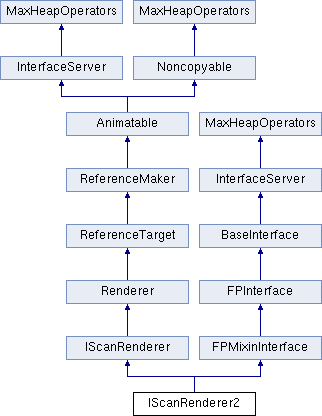

+ Inheritance diagram for IScanRenderer2:
