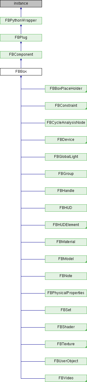

A box is a fundamental building block in the application architecture.
All animatable elements are derived in some way from the main box class, either by deriving directly or owning a box.
Inheritance diagram for FBBox:Public Member Functions | |
