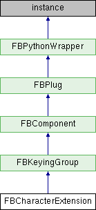

Inheritance diagram for FBCharacterExtension:Public Member Functions | |
