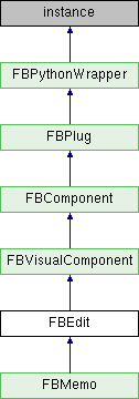

Inheritance diagram for FBEdit:Public Member Functions | |
