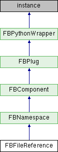

Inheritance diagram for FBFileReference:Public Member Functions | |
