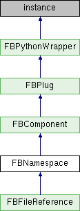

Inheritance diagram for FBNamespace:Public Member Functions | |
