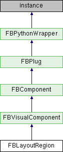

#include <mobu-python-api.h>
Layout region.
Public Member Functions | |
