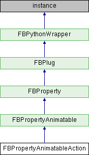

+ Inheritance diagram for FBPropertyAnimatableAction:
