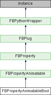

FBPropertyAnimatableBool Class Reference
#include <mobu-python-api.h>
+ Inheritance diagram for FBPropertyAnimatableBool:
Public Member Functions
 __reduce__ ()
str __repr__ (FBPropertyAnimatableBool arg1)
object __str__ (FBPropertyAnimatableBool arg1)
 __init__ (...)
