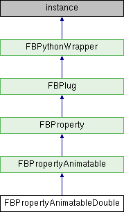

+ Inheritance diagram for FBPropertyAnimatableDouble:
