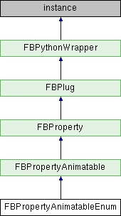

+ Inheritance diagram for FBPropertyAnimatableEnum:
