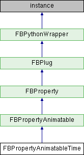

+ Inheritance diagram for FBPropertyAnimatableTime:
