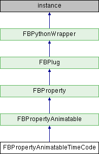

+ Inheritance diagram for FBPropertyAnimatableTimeCode:
