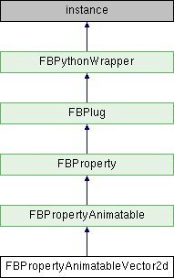

+ Inheritance diagram for FBPropertyAnimatableVector2d:
