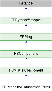

+ Inheritance diagram for FBPropertyConnectionEditor:
