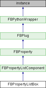

+ Inheritance diagram for FBPropertyListBox:
