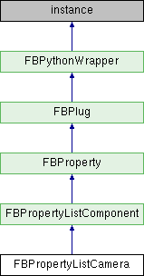

+ Inheritance diagram for FBPropertyListCamera:
