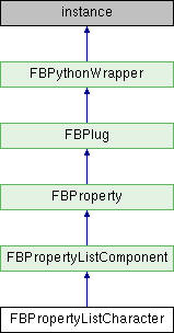

+ Inheritance diagram for FBPropertyListCharacter:
