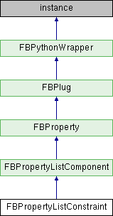

FBPropertyListConstraint Class Reference
#include <mobu-python-api.h>
Class Description
PropertyList: Contraint
+ Inheritance diagram for FBPropertyListConstraint:
