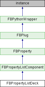

+ Inheritance diagram for FBPropertyListDeck:
