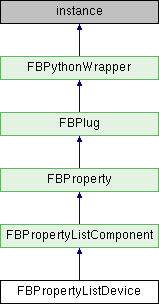

+ Inheritance diagram for FBPropertyListDevice:
