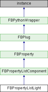

+ Inheritance diagram for FBPropertyListLight:
