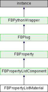

+ Inheritance diagram for FBPropertyListMaterial:
