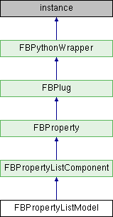

+ Inheritance diagram for FBPropertyListModel:
