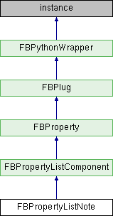

+ Inheritance diagram for FBPropertyListNote:
