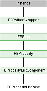

+ Inheritance diagram for FBPropertyListPose:
