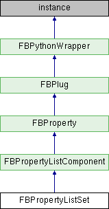

+ Inheritance diagram for FBPropertyListSet:
