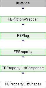

+ Inheritance diagram for FBPropertyListShader:
