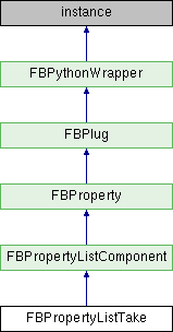

+ Inheritance diagram for FBPropertyListTake:
