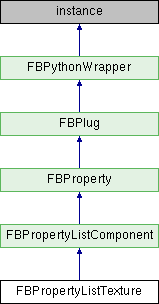

+ Inheritance diagram for FBPropertyListTexture:
