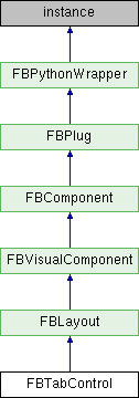

Python Docstring:
A real FBTabControl that improve the behavior of the FBTabPanel.
This class manage the Tabs and the 'middle region' used to display. It manages
all the region 'swapping' necessary to implement a Tab behavior.
- Use Add method to Add a Control to the FBTabControl. This will create a tab
and ensure that when that tab is clicked the Control is shown.
- Use SetContent with a tab index To specify which tab should be displayed.
