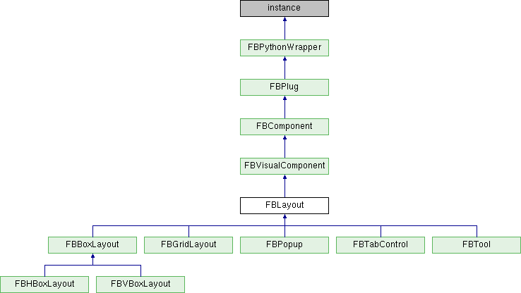

Inheritance diagram for FBLayout:Public Member Functions | |
