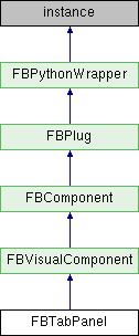

Inheritance diagram for FBTabPanel:Public Member Functions | |
