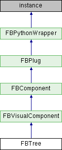

#include <mobu-python-api.h>
Tree list view.
Public Member Functions | |
__reduce__ () | |
Clear (FBTree arg1) | |
Clear the tree (remove all nodes). More... | |
__init__ (object arg1) | |
Constructor. More... | |
