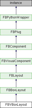

Python Docstring:
This class manages a FBBoxLayout Vertical (see FBBoxLayout for documentation on how to Add/Remove control).
Add method specify the fixed height of a control.
