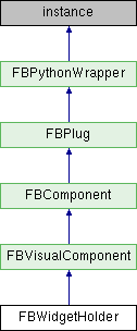

Native Widget Holder (can be used to embed native Qt Widget inside MoBu UI elements) A Widget holder provides a bridge to instantiate a Native Qt widget into MB framework.
This will be used to allow user to create UI with QT designer and hook their created UI into MB. To allow a FBWidgetHolder to work properly, you need to specify a Creator function. This function will be called when needed to instantiate the native Widget. Or override WidgetCreate(QWidget* pParent) function in the subclass. /bin/config/Scripts/UI/ToolNativeWidgetHolder.py for python usage example.
