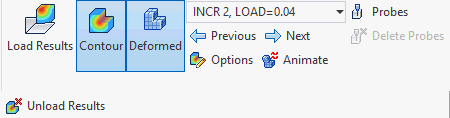

Results
Load Results
Display Contour Plot
Display Deformed Plot
Edit Plot Combo Box (Select Subcases / Increments / Modes / Time Steps / Frequencies)
Previous Step
Next Step
Options - Edit Results (see Plot Templates section)
Single Set Animation
Probe - Query Results
Delete Probes (removes probes you have anchored to the model)
Unload Results (Click Expand arrow to access)
