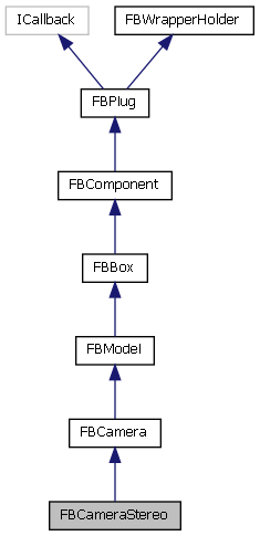

Public Member Functions | |
FBCameraStereo (const char *pName, HIObject pObject=NULL) | |
Constructor. More... | |
FBCamera (const char *pName, HIObject pObject=NULL) | |
void | GetCameraMatrix (FBMatrix &pMatrix, FBCameraMatrixType pType, FBEvaluateInfo *pEvalInfo=NULL) |
Obtains the camera's matrix. More... | |
FBVector4d | InverseProjection (int pX, int pY, double pDistanceFromCamera, bool pRelativeToViewport=false) |
Returns the world coordinates based on screen coordinates and input distance from the camera. More... | |
void | GetAnimatableFarPlane (FBPropertyAnimatableDouble *pProp) |
void | GetAnimatableNearPlane (FBPropertyAnimatableDouble *pProp) |
FBModel (const char *pName, HIObject pObject=NULL) | |
virtual void | FBDelete () override |
Open Reality deletion function. More... | |
IQuery_Declare (override) | |
Interface to IObject. More... | |
ICallback_Declare (override) | |
Interface to ICallback. More... | |
virtual FBModel * | Clone () |
Clone the model. More... | |
void | SetMatrix (FBMatrix pMatrix, FBModelTransformationType pWhat=kModelTransformation, bool pGlobalInfo=true, bool pPushUndo=false, FBEvaluateInfo *pEvaluateInfo=NULL) |
Set a matrix for the model. More... | |
void | GetMatrix (FBMatrix &pMatrix, FBModelTransformationType pWhat=kModelTransformation, bool pGlobalInfo=true, FBEvaluateInfo *pEvaluateInfo=NULL) |
Get a matrix from the model. More... | |
void | GetLocalTransformationMatrixWithGlobalRotationDoF (FBMatrix &pMatrix, bool pInverse=false, FBEvaluateInfo *pEvaluateInfo=NULL) |
Get the local transformation (or local inverse transformation) matrix with the global Rotation DoF values from the model. More... | |
void | SetVector (FBVector3d pVector, FBModelTransformationType pWhat=kModelTranslation, bool pGlobalInfo=true, bool pPushUndo=false, FBEvaluateInfo *pEvaluateInfo=NULL) |
Set a vector for the model. More... | |
void | GetVector (FBVector3d &pVector, FBModelTransformationType pWhat=kModelTranslation, bool pGlobalInfo=true, FBEvaluateInfo *pEvaluateInfo=NULL) |
Get a vector from the model. More... | |
bool | IsEvaluationReady (FBModelEvaluationTaskType pWhat, FBEvaluateInfo *pEvaluateInfo=NULL) const |
Is the model's evaluation task result ready. More... | |
void | MatrixToRotation (FBRVector &pRotation, const FBMatrix &pMatrix) |
Convert Rotation Matrix to Euler Vector based on model's rotation order. More... | |
void | RotationToMatrix (FBMatrix &pMatrix, const FBRVector &pRotation) |
Convert Euler Vector to Rotation Matrix based on model's rotation order. More... | |
void | LRMToDof (FBRVector &pDof, const FBMatrix &pLM) |
Convert local matrix to object space vector. More... | |
void | DofToLRM (FBMatrix &pLM, const FBRVector &pDof) |
Convert object space vector to local matrix. More... | |
void | SetSchematicPosition (int pX, int pY) |
Set the position in the schematic view for the model. More... | |
void | SetSchematicPosition (FBVector2d pVector2d) |
FBVector2d | GetSchematicPosition () |
Get the position in the schematic view for the model. More... | |
void | GetBoundingBox (FBVector3d &pMin, FBVector3d &pMax) |
Get the bounding box of the model. More... | |
bool | IsVisible (FBEvaluateInfo *pEvaluateInfo=NULL) |
If the model is visible. More... | |
FBModelCullingMode | GetCullingMode () const |
Get Model Culling Mode. More... | |
void | SetCullingMode (FBModelCullingMode pCullingMode) |
Set Model Cullin Mode. More... | |
void | ForceAlwaysEvaluate () |
Force Always Evaluate. More... | |
bool | IsForceAlwaysEvaluate () |
Return Force Always Evaluate status. More... | |
int | NoFrustumCullingRequire () |
Acquire no frustum culling request. More... | |
int | NoFrustumCullingRelease () |
Release no frustum culling request. More... | |
bool | UseFrustumCulling () |
Get the current Frustum Culling Status. More... | |
virtual bool | HasCustomDisplay () |
Function to overload to handle custom display. More... | |
virtual void | CustomModelDisplay (FBCamera *pCamera, FBModelShadingMode pShadingMode, FBModelRenderPass pRenderPass, float pPickingAreaWidth, float pPickingAreaHeight) |
Custom display function, called when HasCustomDisplay returns true;. More... | |
virtual bool | CustomModelPicking (int pNbHits, unsigned int *pSelectBuffer, FBCamera *pCamera, int pMouseX, int pMouseY, FBTVector *pLocalRaySrc, FBTVector *pLocalRayDir, FBTVector *pWorldRaySrc, FBTVector *pWorldRayDir, FBMatrix *pGlobalInverseMatrix, FBTVector *pOutPickedPoint) |
Custom picking for selection, called when HasCustomDisplay returns true;. More... | |
virtual bool | ClosestRayIntersection (const FBTVector &pRayOrigin, const FBTVector &pRayEnd, FBTVector &pIntersectPos, FBNormal &pIntersectNormal) |
Determines the first intersection point's position and normal between ray and model surface More... | |
unsigned char * | GetSelectedPoints () |
Get the list of the points selection state. More... | |
int | GetSelectedPointsCount () |
Get the number of selected points in the model. More... | |
bool | SetAdditionalUniqueColorIDCount (unsigned int pCount) |
Request additional Unique color IDs. More... | |
unsigned int | GetAdditionalUniqueColorIDCount () const |
Get additional unique color count. More... | |
FBColor | GetAdditionalUniqueColorID (unsigned int pIndex) const |
Get Additional Unique Color Id. More... | |
virtual bool | FbxStore (FBFbxObject *pFbxObject, kFbxObjectStore pStoreWhat) override |
Store and Retrieve function that can be overloaded. More... | |
virtual bool | FbxRetrieve (FBFbxObject *pFbxObject, kFbxObjectStore pStoreWhat) override |
void | SetupPropertiesForShapes () |
Setup Shape Properties. More... | |
bool | RayCast (FBCamera *pCamera, int pMouseX, int pMouseY, FBVector3d &pHitPosition, FBVector3d &pHitNormal) |
Ray cast test. More... | |
virtual const char * | FbxGetObjectType () override |
Returns the class type inherited by the class of an object, for example: 'Model'. More... | |
virtual const char * | FbxGetObjectSubType () override |
Returns the class sub type inherited by the class of an object, for example: 'Default', 'Mesh'. More... | |
void | SetMatrixWithPrecision (FBMatrix pMatrix, FBModelTransformationType pWhat=kModelTransformation, bool pGlobalInfo=true, bool pPushUndo=false, FBEvaluateInfo *pEvaluateInfo=NULL, double pPrecision=FBMat2EulerDegenerateForPrecision10) |
unsigned int | GetHierarchyWorldMatrices (FBMatrix *pMatricesArray, unsigned int pMatricesArrayCount, FBModelHiercharyTraverserType pHiercharyTraverserType, FBEvaluateInfo *pEvaluateInfo=NULL) |
Computes the global transform matrices between this model and all its children (all levels). More... | |
void | CollapseInSchematic () |
Collapse the model in the schematic view. More... | |
void | ExpandInSchematic () |
Expand the model in the schematic view. More... | |
bool | IsCollapsedInSchematic () const |
Returns if the model is collapsed or not (expanded) in the schematic view. More... | |
virtual bool | ManipulatorNotify (FBSelectionAction pAction) |
Callback for component selection in custom FBModel. More... | |
FBBox (const char *pName, HIObject pObject=NULL) | |
virtual FBAnimationNode * | AnimationNodeInCreate (kReference pUserId, const char *pName, const char *pDataType, bool pIsPublic=false, double *pMin=NULL, double *pMax=NULL, bool pUserData=false) |
Creation of IN/OUT Animation Nodes. More... | |
virtual FBAnimationNode * | AnimationNodeOutCreate (kReference pUserId, const char *pName, const char *pDataType, bool pIsPublic=false, double *pMin=NULL, double *pMax=NULL, bool pUserData=false) |
virtual bool | EvaluateAnimationNodes (FBEvaluateInfo *pEvaluateInfo) |
Evaluation of non TRS nodes that needs to be evaluated. More... | |
virtual bool | AnimationNodeNotify (FBAnimationNode *pAnimationNode, FBEvaluateInfo *pEvaluateInfo) |
Notification function for animation thread. More... | |
virtual bool | ResolveCandidate (FBAnimationNode *pAnimationNode, FBEvaluateInfo *pEvaluateInfo) |
Function is call when candidate needs to be resolved (like global to local). More... | |
virtual ECandidateAction | SetGlobalCandidate (FBAnimationNode *pAnimationNode, double *pData, FBEvaluateInfo *pEvaluateInfo) |
Function is call when a global candidate is set on an animation node. More... | |
virtual ECandidateAction | SetStdCandidate (FBAnimationNode *pAnimationNode, double *pData, FBEvaluateInfo *pEvaluateInfo) |
Function is call when a non-global candidate is set on an animation node. More... | |
virtual bool | AnimationNodeDestroy (FBAnimationNode *pAnimationNode) |
Destroy an animation node. More... | |
virtual bool | AnimationNodeIsUserData (FBAnimationNode *pAnimationNode) |
Is the animation node user data? More... | |
virtual void | AnimationNodesOutDisableIfNotWritten (FBEvaluateInfo *pEvaluateInfo) |
This call will disable all out animation nodes from being pull by system (animation thread) for given pEvaluateInfo. More... | |
virtual FBAnimationNode * | AnimationNodeInGet () |
Get the (IN/OUT) animation node for this box. More... | |
virtual FBAnimationNode * | AnimationNodeOutGet () |
IObject_Declare (override) | |
virtual int | GetOutConnectorCount () const |
Get the number of animation node outputs for this box. More... | |
virtual int | GetInConnectorCount () const |
Get the number of animation node inputs for this box. More... | |
virtual FBAnimationNode * | GetOutConnector (int pIndex) const |
Get the animation node output associated with the given index. More... | |
virtual FBAnimationNode * | GetInConnector (int pIndex) const |
Get the animation node input associated with the given index. More... | |
FBComponent (HIObject pObject) | |
virtual | ~FBComponent () |
Destructor. More... | |
virtual bool | FBCreate () |
Open Reality Creation function. More... | |
virtual void | FBDestroy () |
Open Reality destruction function. More... | |
virtual bool | SetHIObject (HIObject pObject, bool pSDKComponent) override |
Assign component to an internal pointer. More... | |
virtual int | PropertyAdd (FBProperty *pProperty) |
Add a property to the component's property manager. More... | |
bool | PropertyAddReferenceProperty (FBProperty *pReferenceProperty) |
Add a reference property to the component's property manager. More... | |
void | PropertyRemove (FBProperty *pProperty) |
Remove a Property from the component's Property manager. More... | |
void | PropertyGetModifiedList (FBArrayTemplate< FBProperty * > &pPropList, FBPlugModificationFlag pModificationFlags) |
Get list of properties which have been modified since last loading. More... | |
FBProperty * | PropertyCreate (const char *pName, FBPropertyType pType, const char *pDataType, bool pAnimatable, bool pIsUser=false, FBProperty *pReferenceSource=NULL) |
Create user or dynamic property. More... | |
FBObjectFlag | GetObjectFlags () |
Get all Object Flags (concatenated). More... | |
void | SetObjectFlags (FBObjectFlag pFlags) |
SetObjectFlags. More... | |
bool | HasObjectFlags (FBObjectFlag pFlags) |
Check whether a specific object flag is enabled. More... | |
void | EnableObjectFlags (FBObjectFlag pFlags) |
Enable a specific Object Flags. More... | |
void | DisableObjectFlags (FBObjectFlag pFlags) |
Disable a specific Object Flags. More... | |
void | SetObjectStatus (FBObjectStatus pStatus, bool pValue) |
Enable/Disable a specific Object Status. More... | |
bool | GetObjectStatus (FBObjectStatus pStatus) |
Check to see if an object status is enabled. More... | |
bool | ProcessNamespaceHierarchy (FBNamespaceAction pNamespaceAction, const char *pNamespaceName, const char *pReplaceTo=NULL, bool pAddRight=true) |
ProcessNamespaceHierarchy. More... | |
bool | ProcessObjectNamespace (FBNamespaceAction pNamespaceAction, const char *pNamespaceName, const char *pReplaceTo=NULL, bool pAddRight=true) |
ProcessObjectNamespace. More... | |
