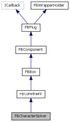

Constraint class. More...
#include <fbcharactersolver.h>
