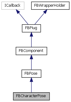

Used to work with character poses.
This class exposes the object used to store the pose of objects.
Definition at line 180 of file fbcharacterpose.h.
