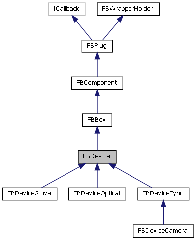

Inheritance diagram for FBDevice:

Detailed Description
Base Device class. Cannot be instantiated from Python.
Definition at line 777 of file fbcore.h.
